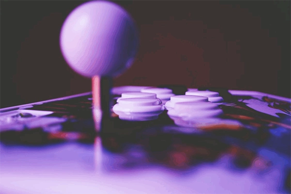

Controls And Sensor Fixes
Unresponsive controls are often a link, not a part. Start with the wiring harness from the control panel to the I/O board. Look for pinched wires under the panel. Check for loose grounds that cause random inputs or “ghost” presses.
Mechanical controls fail in simple ways. Buttons stick when soda dries on the plunger and spring, or when micro-switch blades wear out. Replace the switch, not the whole button. Joysticks loosen at the pivot. Tighten the dust washer nut and check that the restrictor plate is set for the correct game movement.
Sensors on ball toss, puck, or roll games collect dust. Clean the optic pairs with a soft swab and isopropyl alcohol. If a lane sensor still reads wrong, swap the left and right sensor plugs. If the fault moves, the sensor is bad. If it stays, the input channel on the board is the issue.
Many modern cabinets include an operator menu. Use the built-in input test to see live button and joystick states. This test is faster than guessing and shows which input lines fail under load.
