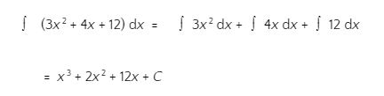

    The constant-coefficient rule allows us to disregard the constant-coefficient in an equation while integrating the remainder of it. Let’s say we wish to compute the indefinite integral of the expression 3x2. According to the constant-coefficient rule, the indefinite integral of this equation is the indefinite integral of x2 multiplied by 3. That is to say:
    Now we just apply the power rule to x 2:

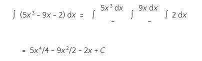

    Let’s have a look at an example. Assume we wish to calculate the indefinite integral of the polynomial function (x) = 5x3 – 9x – 2. Using the sum rule, we obtain:
    The difference and sum rules are fundamentally the same rules. If we wish to integrate a function that comprises both the sum and difference of a number of terms, we must remember to integrate each term independently and to keep the order of the terms in mind. The “+” or “=” sign in front of each expression remains the same.
    You may also conceive the function as the sum of a number of positive and negative terms and apply the sum rule. The order is thus irrelevant; you just need to be aware of the sign of each expression. Below, we have listed few more examples for further interpretation of integration rules.
